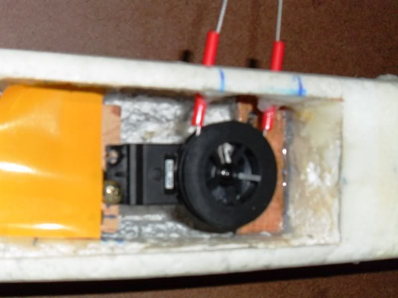

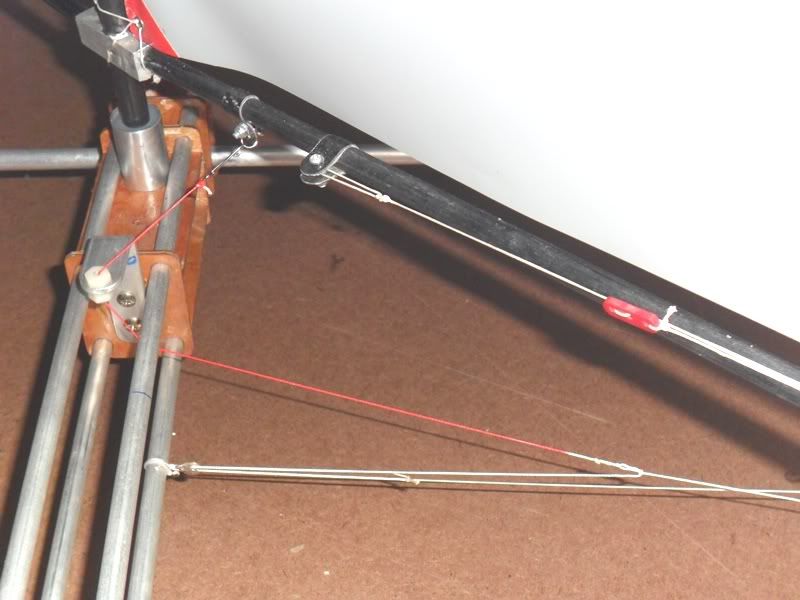

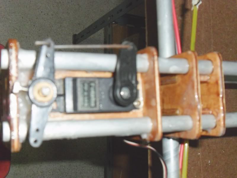

The rudder servo sits direct in front of the rudder with a connection rod to the rudder horn. Sheeting servo sits in the right hull with one pulley to increase the travel and sheet leaves the hull to the sail post attached to the center frame. I will do some pictures for you the next time I’m sailing.

Hi Dick,
here are pics from my rudder connection and my sheeting.
Rudder
Sheeting and drum winch.

thanks for the photos. I was quite surprised by the location of your main-sheet - then remembered you are using a swing rig so you can attach close to the mast than those with a traditional rig who need more main-sheet travel. It will help me when I get back to boat building.

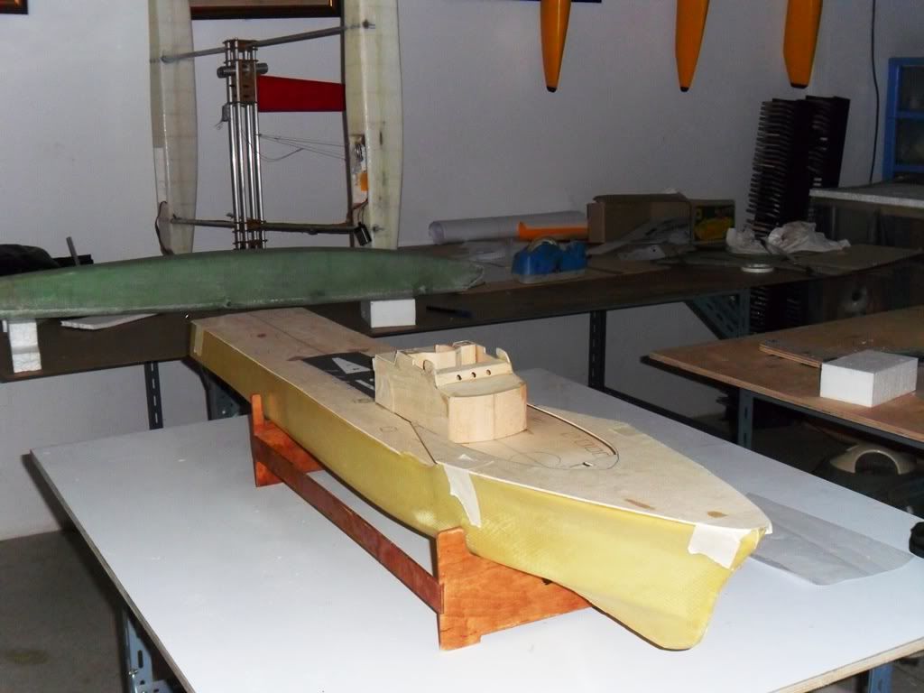

Like most boys he is into engine powered and military things - I have to build a S-boat for him, I promised long ago.

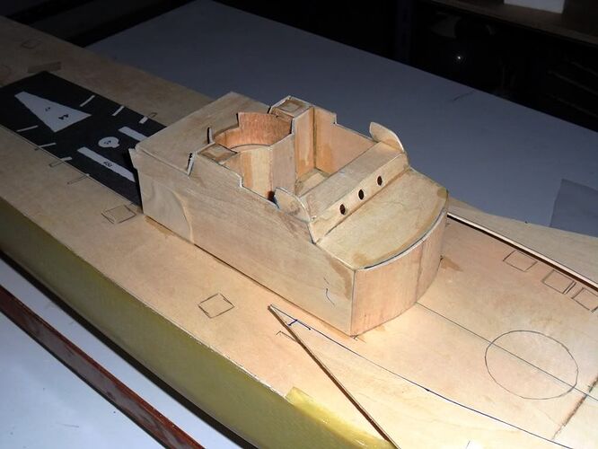

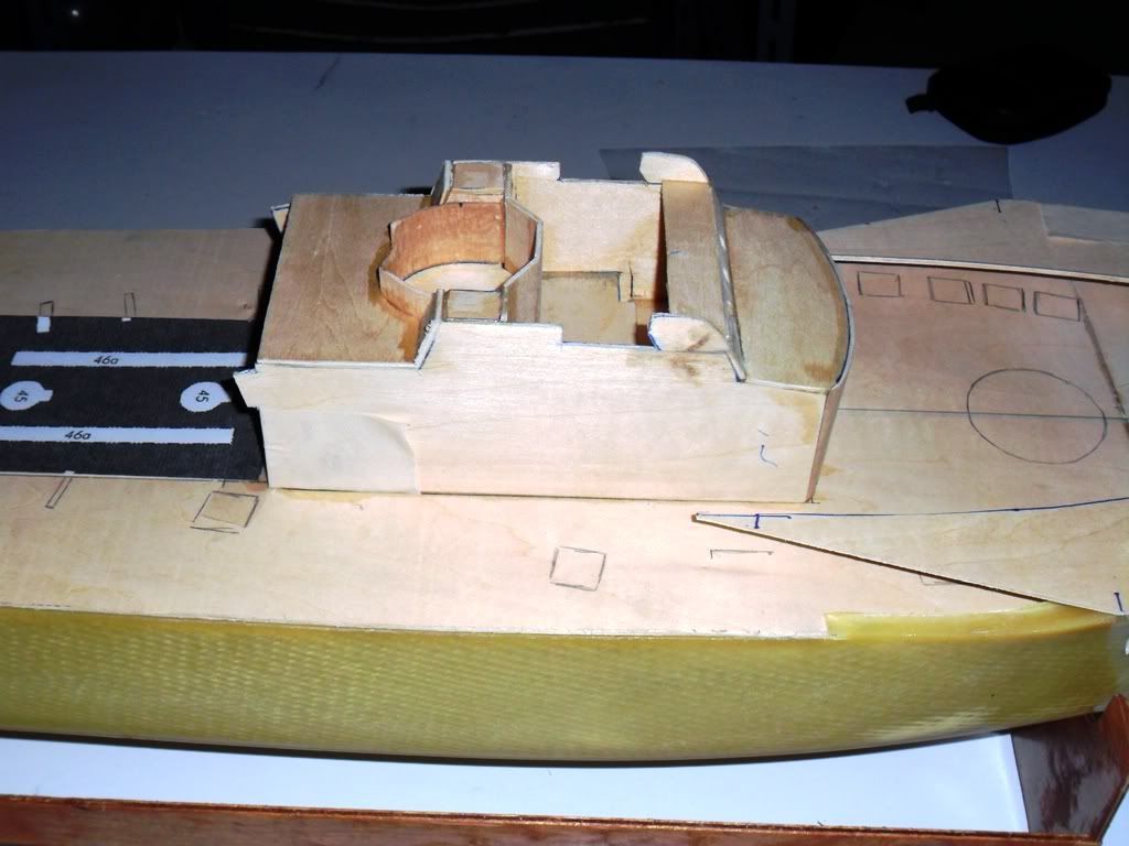

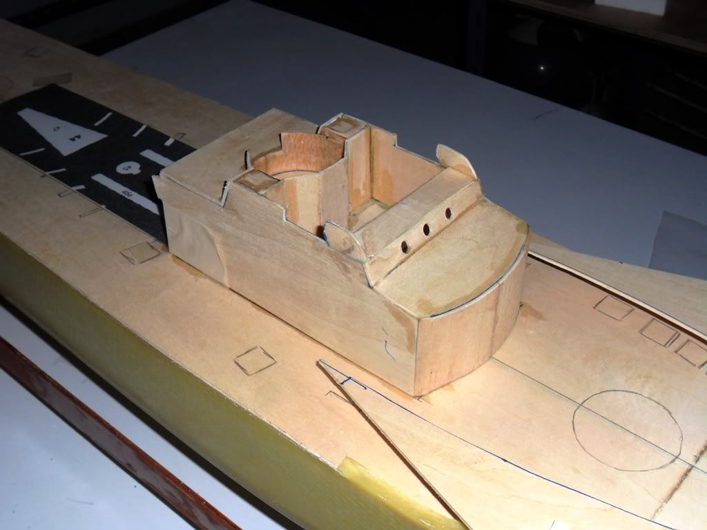

While the plug for the molds of my Cat slowly takes shape I have started to build a Schnellboot from scratch and an old hull I had laying around for ages.
Here are some pics of the boat:
