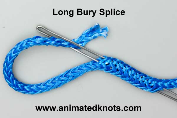

Another great option would be to use a braided hollow core line and do a long bury splice
http://www.animatedknots.com/imagesprelim/long_bury_splice.jpg
