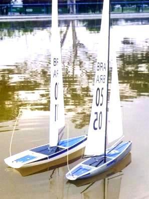

Vad 65 (left) and Hauraki 65 (right) during a race in 2002. Wide vs narrow.

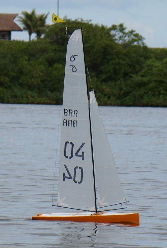

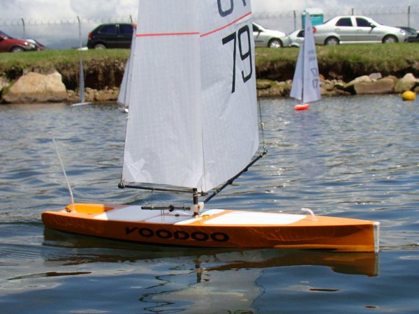

In 2006 a new design, denominated Little Best, ended the dominance of the Vad 65. The Little Best is designed and built by Paulo Stier, Pedro’s uncle, and is a narrow fiberglass hull fitted with a swing rig. The design won the RG 65 South American Championship in 2006 and the 1° RG 65 Brazilian Championship in 2007, both sailed by Pedro Stier. The Little Best achieved an unprecedented success in the RG 65 class in Brazil. In the 2007 Brazilian Championship, from 23 registered boats, 16 were Little Best and only 3 were Vad 65.

Little Best sailing

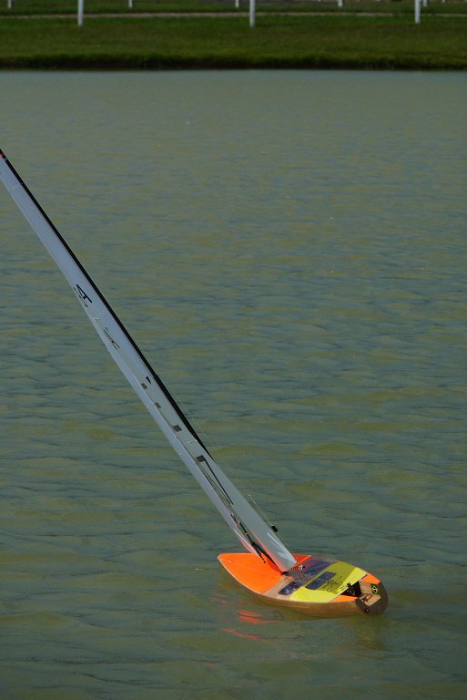

In 2007 new designs were created to try to beat the Little Best. A company called Pro Sails developed the Pro-SR2, a very narrow (10 cm wide) swing rig boat. In Rio de Janeiro, Eduardo Rezende, from Estaleiro Rio, started to build his own swing rig design called Mutante 65, while Rene de Mattos developed the Escambaset, a slight modified Offset (designed by Arne Semken, from Germany) fitted with swing rig. The three boats are commercially available, but haven’t yet achieved the best results on the race course in a national level.
Pro-SR2

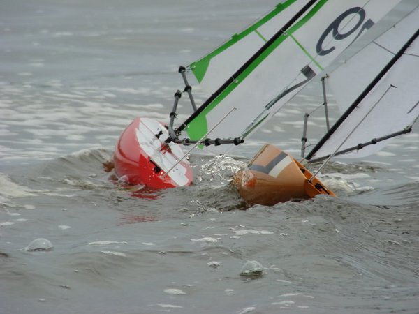

Little Best (red) and Mutante 65 (orange)
Little Best (bellow) and Mutante 65 (above)

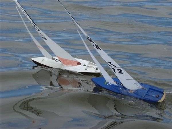

Escambaset (blue) and Mutante 65 (white)

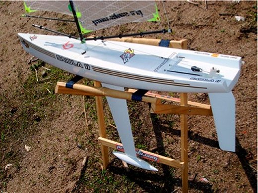

2010 is a promising year for the class in Brazil. New projects are in progress. Seamaster Nautimodelismo (current builder of the Vad 65) has started to produce the Rogue, an RG 65 designed by the famous Graham Bantock. Estaleiro Rio is also building a slight modified Rogue, denominated Mutante II. Pro Sails started to produce a carbon fiber version of the Pro-SR2. Pedro Stier has designed an RG 65 for the first time, called Stinger. People who saw the Stinger sailing said it is a rocket.
Pro-SR2 - carbon fiber version, by Pro Sails

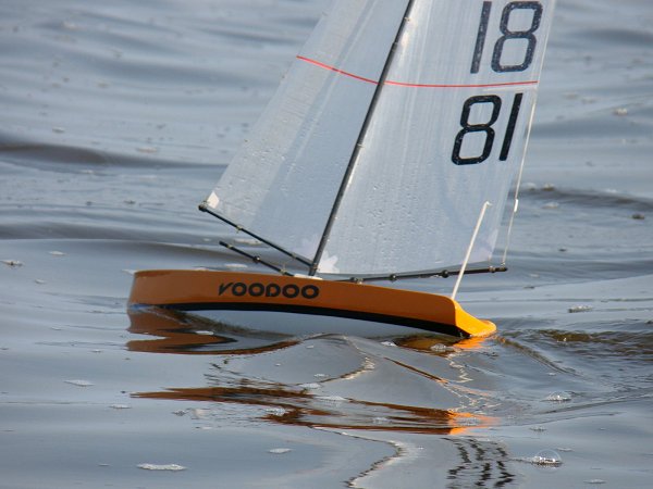

Here’s some pictures of the Seabug which I mentioned in an earlier post as a good boat for a first time builder that also has very good performance. The Mk I has yellow sails and Mk II has the black sails. They are both fast and although it’s difficult to see much difference in the pictures the Mk II has slightly more volume in the bow. An interesting feature of the Mk II boat shown in the picture is the depron deck which helps make it even quicker to build a light weight hull.
