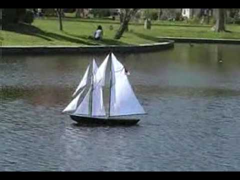

Hi,
Have a look at my boat :slight_smile:
http://www.youtube.com/watch?v=1xsoKRAVrqw
