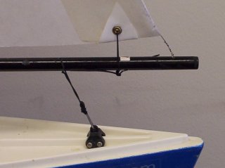

Why do we rig our forestay this way. Perhaps so the jib can reach farther forward?

Two basic reasons.
Stand back, look at your rig and follow along. When you tighten the back stay, the top of the mast is pulled aft. This causes more tension to be applied to the forestay. The forestay, then, pulls harder on the fore part of the jib boom and tries to lift it upwards. Because of the fulcrum at the attachment point with the line going to the deck, the aft end of the jib boom is pulled down towards the deck. This is your basic jib leech adjustment. The tighter the backstay, the straighter the leech. This is how the Soling One Meters do it. Other classes allow a jib topping lift to aid in adjusting the jib leech and rig tension.
When running directly downwind, if the sails are on the same side of the boat, most of the jib’s area is in the main’s wind shadow. The little bit that protrudes into clean air is enough for the wind to catch it and flip it to the other side, allowing the sails to go wing-on-wing.
Pro & Con as well -----
Benefit of exisiting jib boom setup is as noted - you can control leech tension and along with clew tension on jib boom, can vary the camber (curvature) in the jib - getting a flat or full blade.
If you run from the forestay it is posssible, but as soon as you sheet out, the clew tension decreases, allowing the jib to instantly get full. Remember that without sheeting to each side of the deck, or use of a traveller, you are controlling the clew end of the sail from the middle of the deck. To get the same benefits of tight leech, you would have to have sheets run to each side of the deck, and probably some jib cars on each side to move forward/aft to vary the pull on the sail by the sheets. Move cars aft, and get a tight foot, but “soft” leech. Move cars forward and you get a tight leech but a “soft” foot. Also need a winch to handle dual side sheeting, which is an extra channel, which is often illegal by class rules as it would require a 3 channel set up.
A negative for the above photo setup is that it moves the forward leading edge of the jib (luff) to windward when sailing upwind. In order to get the proper angle of attack, you would have to foot off slightly to return the leading edge back in line with the wind. Having the jib luff on a normal bigboat forestay would/should allow the boat to point a few degrees higher. I think the photo is what has been found to be the best compromise - maintaining leech control by giving up a couple of degrees of pointing.
A “Hoyt” type boom is a third alternative where the luff is run on a forestay, and the boom comes out of the deck slightly behind the foestay and clew is fastened to it. In this case, the jib boom doesn’t lift up when sheet tension is loosened, so you can still maintain leech control and have the luff on a forestay like a big boat. Doug Lord had discussed this in depth (technically) so if you search “Hoyt Boom” you might find more discussion in archives - if they are still there.
If you go with an overlapping headsail, (Genoa or maybe a 125% jib) then the boom arrangement will not work as it would hit the mast when tacking. The self-tacking boom (like your photo) eliminates a lot of issues that crop up when trying to get your headsail equal to your foretriangle of 100% (more like 90%).
Wanted to go a bit deeper into theory as a self-tending boom and a jib set on a true forestay can work - but you have to give up some adjustments to get the look. Either way, a jib can run downwing wing-and-wing (sails on opposite sides of hull) it’s just easier to do with the setup as in your photo.
