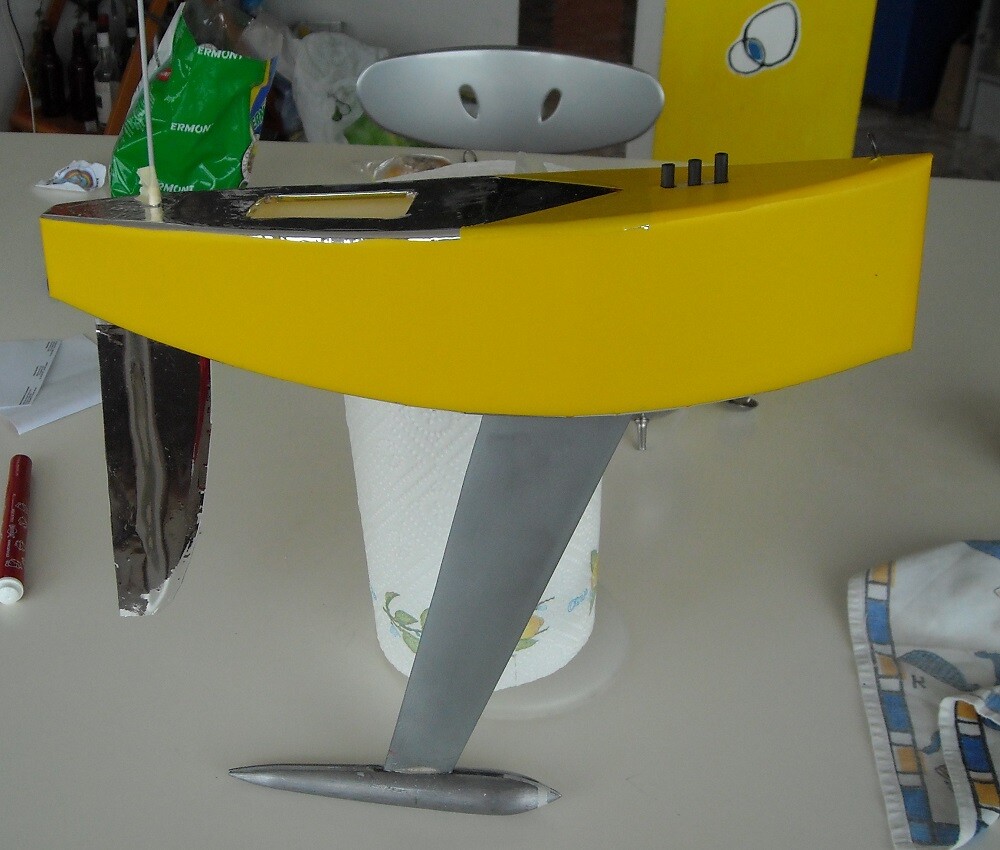

EDIT December 8th
After having asked all those questions, it is time to share :wink:
My easy III is now finished (has not sailed yet)
I have asked Claudio about fitting an AlpYachts UNA Rig, and this s what I did (therefore the three mast holes)
Otherwise it is pretty much a vanilla Easy III
the lead bulb is a 300 (really 284 gr) fishing lead that I dig and hammered (i could probably cover him with mastic to get a decent look)
So
  • hull is 70 gr (40 of them is the PVC film !!! )
  • Radio cassette with servo and batterie is 65 gr
  • rig fully rigged is 20 gr
  • Bulb is 284 + glue
Here is a link to a photo album
So Claudio thank you again very much for this design and all the help you provided !!
