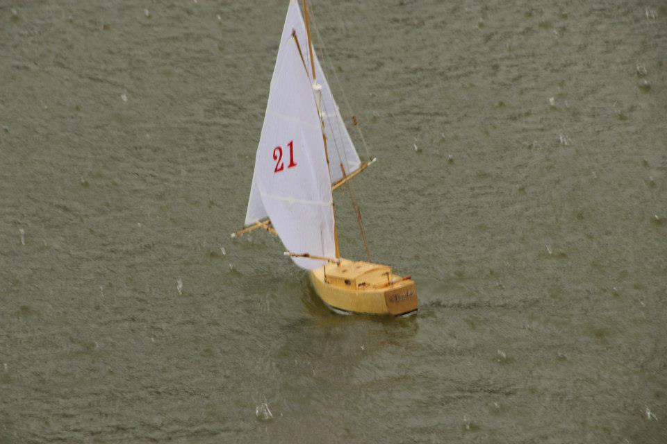

this is my old Presto under strong gusts and cold showers
