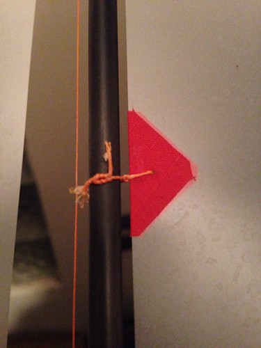

Yes, the string loops took me 2 or 3 attempts to get the gap and sail shape I was happy with.
love the servo mount…
No need to use spacers/gap if you to a small knot between sail and mast. See image.
It will take a breeze but it helps to enable for shifting the battery aft because it will nose dive.
I should note that my sail number is actually 63, the 163 on this boat is only there for when I put two boats
in letting a friend sail my other RG “Razor” so its easier to tell them apart :slight_smile:
tarm… th only problem with the knot method is that you still have the potential to tie the loop too tight around the mast which could prevent the sail from rotating. i take a small block 1/2"x1/2"x1/2" of wood and cut a groove, leaving a couple mm remaining. slip the groove into the luff of the sail at the hole and then tie. Move wood block to nexct spot…repeat.
the gap created by the remaining wood is your space. Easy and repeatable and it still allows the main to move freely on the mast On my victoria and RG I use a carbon rod in the luff pocket of the main to prevent and sagging of the main or getting any puckers between the tie points…
